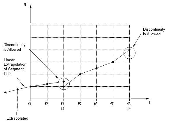

- Discontinuities may be specified between any two points. If g is evaluated at a discontinuity, then the average value of g is used. In Figure 1, the value of g at f = f3 is g = (g3 + g4)/2. If the y-axis is a LOG axis, the jump at the discontinuity is evaluated as

where f is input to the table and g is returned. The table look-up is performed using linear interpolation within the table and linear extrapolation outside the table using the two starting or end points, see Figure 1. No warning messages are given if table data is input incorrectly. The algorithms used for interpolation or extrapolation are:XAXIS YAXIS y(x) LINEAR LINEAR

Figure 1. Example of Table Extrapolation and Discontinuity
