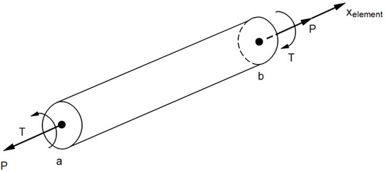

Figure 1. CROD Element Internal Forces and Moments
