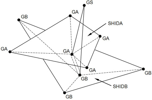

Figure 1. Patch-to-Patch Connection Defined with FTYPE Equal to GRIDID or ELEMID

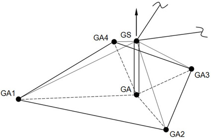

Figure 2. Patch-to-Point Connection Defined with FTYPE Equal to GRIDID or ELEMID

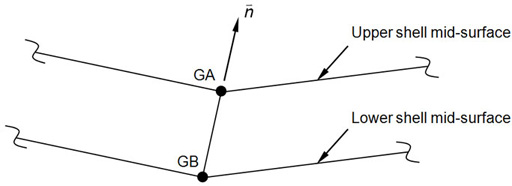

Figure 3. Point-to-Point Connection Defined with FTYPE Equal to ALIGN

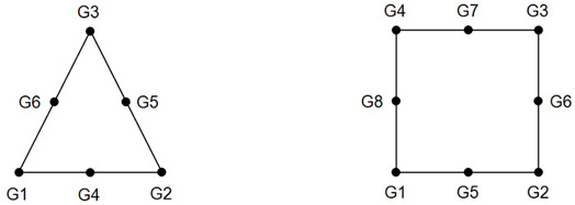

- GAi are required for FTYPE = GRIDID. At least 3 and at most 8 grid point identification numbers may be specified for GAi and GBi, respectively. Triangular and quadrilateral element definition sequences apply for the order of GAi and GBi.
Figure 4. Triangular and Quadrilateral Surface Patches Defined with Format GRIDID
