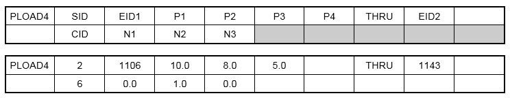

Format:
Example:
Alternate Format and Example:
| Field | Definition | Type | Default |
| SID | Load set identification number. | Integer > 0 | Required |
| EID | Element identification number. | Integer > 0 | Required |
| P1, P2, P3, P4 | Load per unit surface area (pressure) at the corners of the face of the element. | Real or blank | P1 is the default for P2, P3, and P4 |
| G1 | Identification number of a grid point connected to a corner of the face. | Integer > 0 or blank | Required for solid elements |
| G3 | Identification number of a grid point connected to a corner diagonally opposite to G1 on the same face of a CHEXA, CPENTA, or CPYRA element. Required for the quadrilateral faces of CHEXA, CPENTA, and CPYRA elements. Must be omitted for a triangular face on a CPENTA or CPYRA element. | Integer > 0 or blank | Required for CHEXA and CPENTA elements |
| G4 | Identification number of the CTETRA grid point located at the corner; this grid point may not reside on the face being loaded. | Integer > 0 or blank | Required for CTETRA elements |
| CID | Coordinate system identification number. | Integer ≥ 0 or blank | See Remark 2 |
| N1, N2, N3 | Components of vector measured in coordinate system defined by CID. Used to define the direction (but not the magnitude) of the load intensity. | Real | Required if CID is not blank and must have at least one non-zero component |

- The continuation entry is optional. If fields 2, 3, 4, and 5 of the continuation entry are blank, the load is assumed to be a pressure acting normal to the face. If these fields are not blank, the load acts in the direction defined in these fields. Note that if CID is a curvilinear coordinate system, the direction of loading may vary over the surface of the element. The load intensity is the load per unit of surface area, not the load per unit of area normal to the direction of loading.

- The alternate format is available only for CTRIA3, CTRIAR, CQUAD4, and CQUADR elements. The continuation entry may be used in the alternate format.
