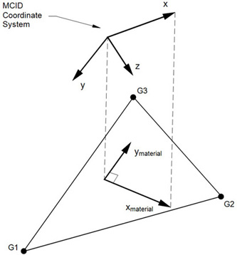

| THETA | Material property orientation angle in degrees. | Real | See Remark 7 |
| MCID | Material coordinate system identification number. | Integer ≥ 0 | See Remark 7 |

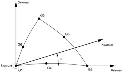

- Grid points G1 through G6 must be ordered as shown.
- Any or all of the edge points, G4 through G6, may be deleted. If the ID of any edge connection points is left blank or set to zero, the element equations are modified to give the correct results for the reduced number of connections. Corner grid points cannot be deleted.
- It is recommended that the midside grid points be located within the middle third of the edge. If the edge point is located at the quarter point the element may become singular.

- If THETA/MCID is blank, field 5 of the PSHELL continuation entry will be used. If this field is also blank, then THETA = 0.0 is assumed when a non-isotropic material is referenced.

Figure 1. MCID Coordinate System Definition
Figure 2. CTRIA6 Element Geometry and Coordinate System

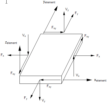

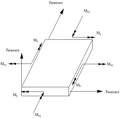

Figure 3. Forces and Moments in CTRIA6 Elements

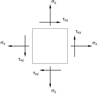

Figure 4. Stresses in CTRIA6 Elements
