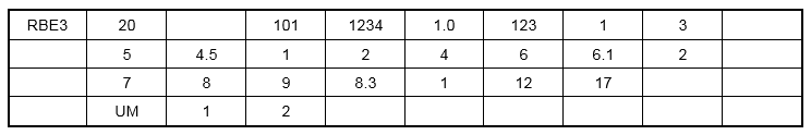

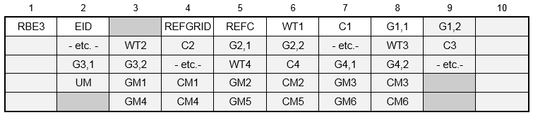

Format:
Example:
| Field | Definition | Type | Default |
| EID | Element identification number. | Integer > 0 | Required |
| REFGRID | Reference grid point identification number. | Integer > 0 | Required |
| REFC | Component numbers at the reference grid point. (Up to six unique digits may be placed in the field with no embedded blanks.) | 1 ≤ Integers ≤ 6 | Required |
| WTi | Weighting factor for components of motion at grid points Gi,j. | Real | Required |
| Ci | Component numbers with weighting factor WTi at grid points Gi,j. (Up to three unique digits may be placed in the field with no embedded blanks.) | 1 ≤ Integers ≤ 6 | Required |
| Gi,j | Grid points whose components Ci have weighting factor WTi in the averaging equations. | Integer > 0 | Required |
| GMi | Grid points whose components CMi are to be made dependent. See Remark 7. | Integer > 0 | Required |
| CMi | Component numbers of GM. (Up to six unique digits may be placed in the field with no embedded blanks.) See Remark 7. | 1 ≤ Integers ≤ 6 | Required |
