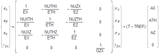

- The stress-strain relationship is:
where,
