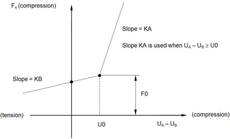

| U0 | Initial gap opening. See Figure 2 and Remark 1. | Real or AUTO | 0.0 |
| F0 | Preload. See Figure 2. | Real | 0.0 |
| KA | Axial stiffness for the closed gap (i.e. U A - U B > U0). See Figure 2. | Real > 0.0 | Required |
| KB | Axial stiffness for the open gap (i.e. U A - U B < U0). See Figure 2 and Remark 3. | Real ≥ 0.0 or blank | 10 -10 * KA |

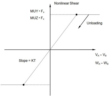

| KT | Transverse stiffness when the gap is closed. See Figure 3. It is recommended that KT ≥ (0.1 * KA). | Real ≥ 0.0 | MUY * KA |
| MUY | Coefficient of friction in the y transverse direction
. See Remark 4.
Real ≥ 0.0 | 0.0 |
| MUZ | Coefficient of friction in the z transverse direction
. See Remark 4.
Real ≥ 0.0 | 0.0 |

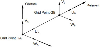

- The default initial gap opening is zero. If AUTO or -1.0 is specified, the initial gap opening will be set to the initial element length. This is particularly useful when defining multiple gap elements over an uneven surface.
- Figures 1 through 3 show the gap element and the force-displacement curves used in the stiffness and force computations for the element.
- For most contact problems, KA (penalty value) should be chosen to be three orders of magnitude higher than the stiffness of the neighboring grid points. A much larger KA value may slow convergence or cause divergence, while a much smaller KA value may results in inaccurate results. The value is adjusted as necessary if TMAX > 0.0.
- When the gap is open, there is no transverse stiffness. When the gap is closed and there is friction, the gap has the elastic stiffness (KT) in the transverse direction until the friction force is exceeded and slippage starts to occur.

Figure 1. GAP Element Coordinate System
Figure 2. GAP Element Force-Deflection Curve for Nonlinear Analysis
Figure 3. GAP Element Shear Forces for Nonlinear Analysis
