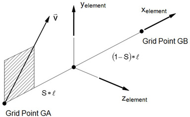

- The bush element geometry is shown in Figure 1 below.
- CID ≥ 0 overrides G0 and (X1, X2, X3). Then the element x-axis is along T1, the element y-axis is along T2, and the element z-axis is along T3 of the CID coordinate system. If the CID refers to a cylindrical coordinate system or a spherical coordinate system, then grid GA is used to locate the system. If for cylindrical or spherical coordinate, GA falls on the z-axis used to define them, it is recommended that another CID be selected to define the element x-axis.
- For noncoincident grids (GA ≠ GB), when G0 or (X1, X2, X3) is given and no CID is specified, then the line GA - GB is the element x-axis and the orientation vector
lies in the x-y plane (similar to the
CBEAM element).
- For noncoincident grids (GA ≠ GB), if neither G nor (X1, X2, X3) is specified and no CID is specified, then the line GA - GB is the element x-axis. This option is valid only when K1 (or B1) or K4 (or B4) or both on the PBUSH entry are specified (but K2, K3, K5, K6, or B2, B3, B5, B6 are not specified). If K2, K3, K5, or K6 (or B2, B3, B5, or B6) are specified, a fatal message will be issued.

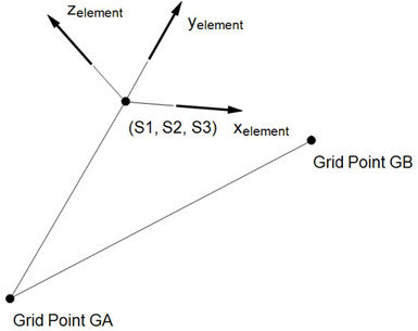

- If OCID = -1 or blank (default) then S is used and S1, S2, S3 are ignored. If OCID ≥ 0, then S is ignored and S1, S2, S3 are used.
Figure 1. CBUSH Element Coordinate System
Figure 2. Definition of Offset S1, S2, S3
