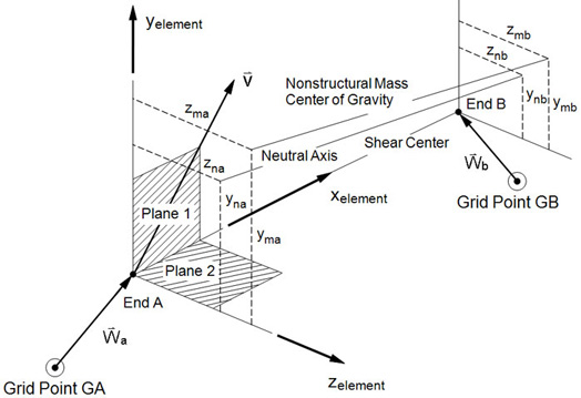

- Figure 1 below defines beam element geometry.

Figure 1. CBEAM Element Geometry System

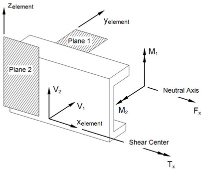

Figure 2. CBEAM Internal Element Forces and Moments
