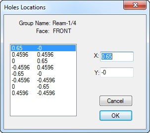

Holes Locations dialog (PartMaker)
Use the Holes Locations dialog to display, or change, the locations of all holes in the work group.
To display this dialog, select a hole group from the Job Explorer pane, then select Part Features > Holes Locations.
The list displays all the hole locations. Select a hole from this list to view, or change, its coordinates.
X — Enter the hole's X-axis-coordinate.
Y — Enter the hole's Y-axis coordinate.
