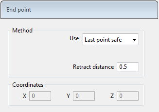

End point (PartMaker, Advanced Milling Toolpaths)
Use the End point page to define the location of the tool at the end of the toolpath.
Method
  • Use — Select the location of the end point. The values available are the same as for the start point, see Start point for more details.
  • Retract distance — Enter the length of the retract move at the end of the toolpath.
Coordinates — Enter the absolute coordinates of the end point. Only available when Absolute is selected as the method of defining the location of the end point.
