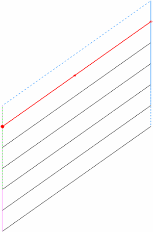

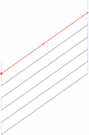

Cut Direction — Select whether or not the toolpath changes direction between axial steps.
  • Uni-Directional — Select this option so that after the tool completes a pass of the toolpath in one direction, the next pass in depth is in the same direction.
  • Bi-Directional — Select this option so that after the tool completes a pass of the toolpath in one direction, the next pass in depth is in the reverse direction. This minimizes tool lift and travel.

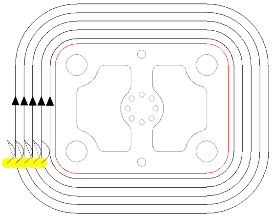

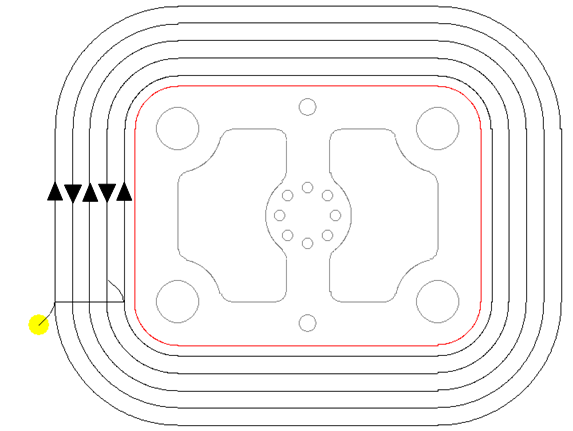

Toolpath Direction — Select whether or not the toolpath changes direction between radial steps:
  • Uni-Directional — Select this option so after the tool completes a pass of the toolpath in one direction, the next pass over is in the same direction.
  • Bi-Directional — Select this option so after the tool completes a pass of the toolpath in one direction, the next pass over is in the reverse direction. This minimizes tool lift and travel.
