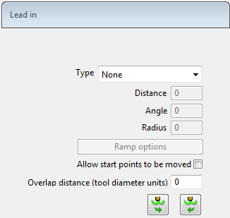

Use the Lead in page to control the movement of the tool as it approaches the stock, before beginning a cutting move.
Note: The settings in this page are not available for Vortex toolpaths.
Type — Select the type of Lead in move to use before each cutting move.
Distance — Enter the distance to extend the Lead in move before the cutting move starts. If this is an arc move, then the distance is the length of the linear tangential move between the arc and the cutting portion of the toolpath.

Angle — Enter the angle of the Lead in move relative to the toolpath segment. For arcs, this is the angle spanned by the arc. For lines, it is the orientation relative to the cutting move.

Radius — Enter the radius of the Lead in arc move.

Ramp Options — Click to display the Ramp Options dialog, where you can specify how the tool ramps into the stock when using a Ramp-type move. This is available only when a Ramp move is selected as the Type of Lead in move.
Allow start points to be moved — Select this option to allow PartMaker to move start points on closed loops automatically to try and find a non-gouging position. When deselected, PartMaker will not move the start points.
Overlap distance (tool diameter units) — Enter the distance by which a lead-in move can overlap a closed toolpath segment.
— Click to copy the Lead in values to the Lead out page.
— Click to copy the Lead out values to the Lead in page.
