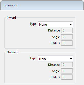

Use the Extensions page to add another lead to the existing ones.
Inward — Use these settings to add an additional Lead in before the existing one.
Extension of Straight with a Distance of 10, and an Angle of 0. Leads of Surface normal arc.
  • Type — Select the type of inward extension move to use. The options available are a subset of the types of Lead in move.
  • Distance — Enter the length of the inward extension move.
    With a Distance of 10.

  • Angle — Enter the angle span of the inward extension move.
    With an Angle of 0.

    With an Angle of 90.
  • Radius — Enter the radius of the inward extension move.

Outward — Use these settings to add an additional Lead out before the existing one.

  • Type — Select the type of outward extension move to use. The options available are a subset of the types of Lead out move.
  • Distance — Enter the length of the outward extension move.

  • Angle — Enter the angle span of the outward extension move.
    With an Angle of 0.
  • Radius — Enter the radius of the outward extension move.
