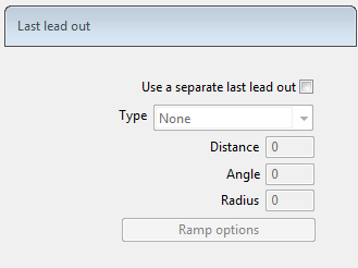

Use the Last lead out page to specify a Last lead out move that is different from the lead out moves used elsewhere.
Use a separate last lead out — Select this option to specify a separate Last lead out move.
Type — Select the type of move to use at the end of the toolpath.
Distance — Enter the distance to extend the Last lead out move after the end of the last cutting move. If this is an arc move, then the distance is the length of the linear tangential move between the arc and the cutting portion of the toolpath.
- With a Distance of 0.
A Last lead out of Surface normal arc with a Distance of 0, an Angle of 90 and a Radius of 5. - With a Distance of 10.
Angle — Enter the angle of the Last lead out move relative to the last toolpath segment. For arcs, this is the angle spanned by the arc. For lines, it is the orientation relative to the cutting move.
With an Angle of 90
With an Angle of 180
- For a First lead in of Straight and Angle of 0
- With an Angle of 90
Radius — Enter the radius of the Last lead out arc move.
- With a Radius of 5.
A Last lead out of Surface normal arc with a Distance of 0, an Angle of 90 and a Radius of 5. - With a Radius of 10.
Ramp Options — Click to display the Ramp Options dialog, where you can specify how the tool ramps into the stock when using a Ramp-type move. This is available only when a Ramp move is selected.
